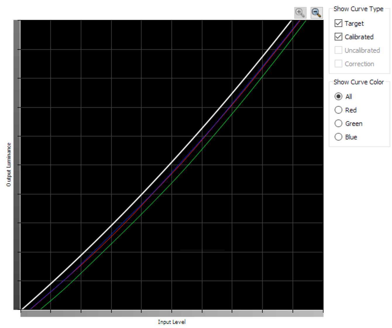

02 maja 2019, 08:59 - czw
Niestety, kolejny monitor jaki badam ma ten sam defekt. Także chyba problem nadal nie jest rozwiązany.
Bad news...
Is your recomendation to choose the sligthly more expensive CG279x?
Somebody linked this "user review" in this forum:
https://youtu.be/klDxwZALvis
Validated with an uncorrected i1DisplayPro it showed strong color cast in grey after calibration (11min 21 sec). I mean, an uncorrected i1DisplayPro may see wrong white point, but here it is seeing a color cast in grey ( a big difference from its white point, it is in green-magenta axis, it should be very noticeable) which should be the same spectral distrubution but with lower light intensity.
Is this model broken too?
04 maja 2019, 13:51 - sob
I do not confirm this problem. It is possible, that calibration and validation of another CMF.
